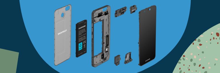

  • Pioneering the path to circularity
    The "circular economy", a concept that is becoming more and more prominent in the current Zeitgeist. In short, it's an economic system aimed at eliminating waste and facilitating the continual use of resources. A world in which we are genuinely circular is one where materials can be used, recycled and reused to their fullest extent....
